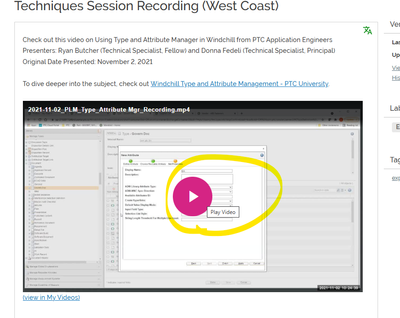

Check out this video on Using Type and Attribute Manager in Windchill from PTC Application Engineers
Presenters: Ryan Butcher (Technical Specialist, Fellow) and Donna Fedeli (Technical Specialist, Principal)
Original Date Presented: November 2, 2021
To dive deeper into the subject, check out Windchill Type and Attribute Management - PTC University.
