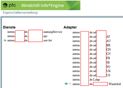

2. question
we have 11 AD Adapters for different countries.
do we have to reconnect all 11x after rehost/clone with the xconfmanager to D:\ptc\Windchill_12.1\Windchill\site.xconf  ? Because each adapter has it own password?
