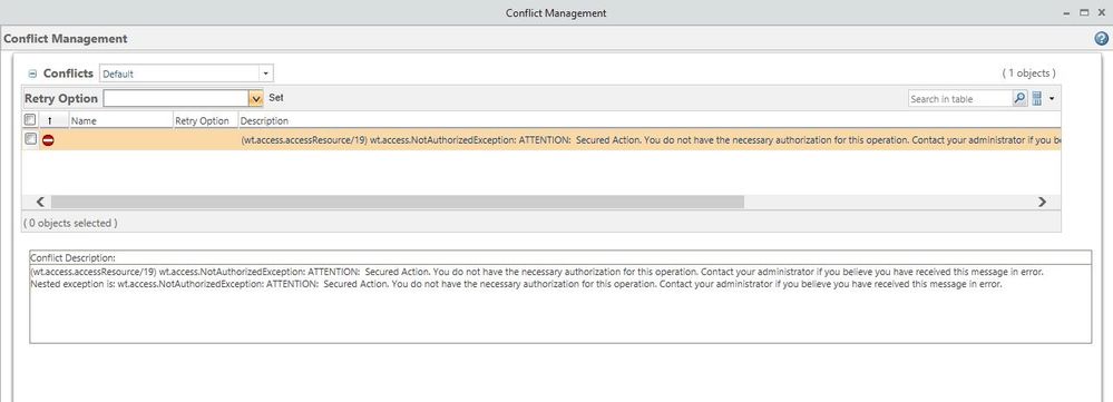

This evening, when several students tried to check out files from our Windchill server, the check out failed (and check in) and this error message came up in the Event Management console: "WTRuntimeException: ATTENTION:  Secured Action. You do not have the necessary authorization for this operation. Contact your administrator if you believe you have received this message in error. Nested exception is:
 (wt.access.accessResource/19) wt.access.NotAuthorizedException: ATTENTION:  Secured Action. You do not have the necessary authorization for this operation. Contact your administrator if you believe you have received this message in error"

Not sure what you're asking for screenshots of.... Here's the error that comes up in the Event Manager. Capture.JPG

It sounds like someone changed some permissions.  This is the exact message we get when someone isn't allowed access to something (based on their permissions.)
