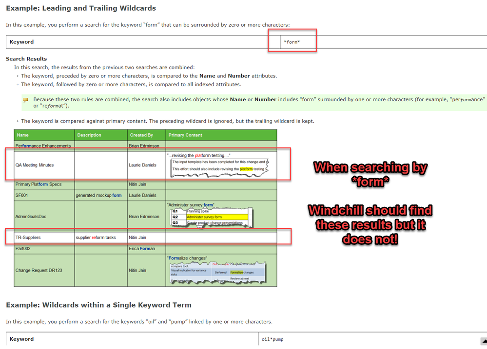

Even more annoying however is that even when you use wildcards correctly you may still not find what you are working for as shown by the following examples in the documentation (which we have butted up against):
https://support.ptc.com/help/windchill/wc110_hc/whc_en/index.html#page/Windchill_Help_Center%2FLclSrchAdvancedSearchExampleWildcards.html%23
