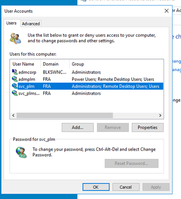

Pascal_Brunet
(To:BenLoosli)
i had similar problem in 12.0.0.3. I solved it by replacing local system by an administrator account. Check my original note i created last time it happened to me.
svc_plm is not an account i created myself on the server. It is an account created by our Server team in the Enterprise Active Directory:
Hope it can help.
Pascal
