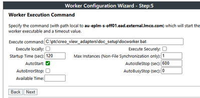

Hi All,
I am facing the same issue where I need to restart Worker daemon service manually, every time I re-boot windchill server and office worker server. The current situation is, We do monthly maintenance / backup and some update work. in result we need to restart Windchill services, server and publishing servers like office worker/Creo worker. We have to restart worker daemon service manually, it does not start itself. below is my current setting which shows it is set to automatic start and also /opt/ptc/Windchill_13/Windchill/conf/wvs/agent.ini file shows it autostart. but still we need to start it manually. Our office / Creo worker agent is windows server. out Windchill main server is Linux.

1. If Windows OS go to Service> Gs Worker Deamon / PTC Worker Deamon> Properties>Recovery> First Failure - Restart services> Second Failure - Restart Services> Substantial Failure - Run Program> Program> Browse> Locate to Worker Deamon & Select> Ok. This will restart automatically without any manual processes if services fails to start. After doing these steps. Still, when I re-booted the office worker windows server.  I need to start worker daemon manually.
2. In Worker Agent Administrator >Step 6/7> click AutoStart CheckBox. Done

we're running both SolidWorks 2023 and Office worker on the same server Windows 2022. I never start Office worker separately after a worker server reboot. PTC Worker daemon configured as a service as in your picture, autostart is set to Yes. When a job to publish Word or Excel as pdf enters the queue the Office worker fires up.
