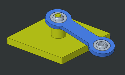

I created an assembly representing a commercial ball joint, called SKF_GE-4-C. This assembly is composed by a housing mounted by default and a sphere mounted with a "ball" connection type. If I drag components, everything is working fine at this level.
Then I used this file as a component for another assembly called SUB, mounted as rigid. If I drag components, everything is working as expected at this level as well.
However, when I insert SUB in another assembly called MAIN and try to constrain the hole of the ball with a fixed shaft, everything locks in place. I am not able to move the beam with drag components as I intend to do.
Is it possible to get it to move preserving the same (or a similar) structure of assembly? What do you suggest?

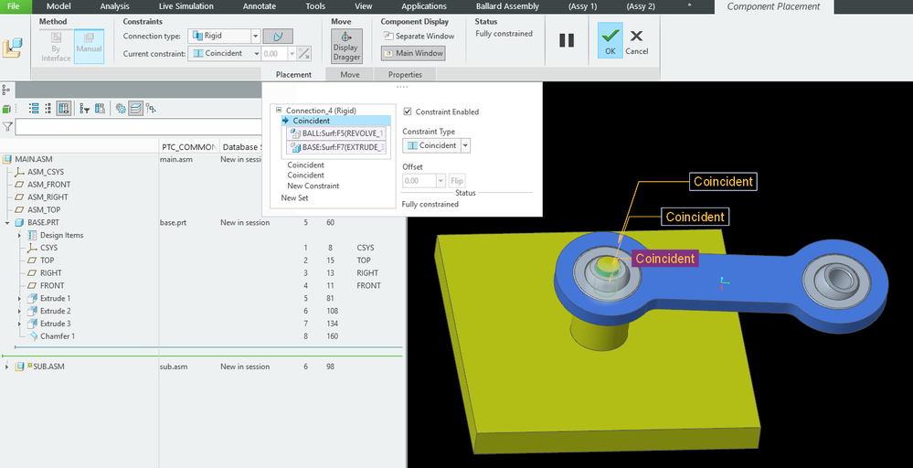

I know that it often works, but sometimes it just gives weird results.  For your situation, try to see if the mechanism works if you re-define the connection between the ball element and the base to be of "Rigid" type:
I would also recommend that you fully constrain everything.  Avoid use of the "assumed" constraints.

I was really surprised to see this simple suggestion working for me. I can now move the beam while keeping the same assembly structure, thank you.
What is the difference between "User defined" and "Rigid" connection type? I have used them interchangeably but now I understand they are different.
