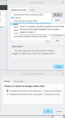

NOTE - The part i created below is mm/g/sec
1. I create a basic square at H266.70mm(10.50") X W101.70(4.00") X T1.52(0.06").
2. After, I convert it to inches/lbm/seconds.
Results it would shrink the size of the square.
Below is MM
After converted
Result of change
In comparison

  • I guess your problem is related to Custom system of units
Please do following test:

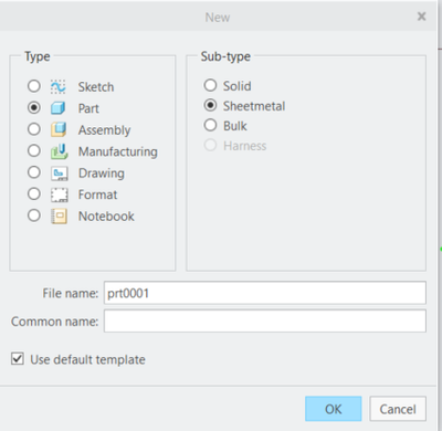

  • create new sheetmetal part
    • do not use your template
    • use PTC template named mmns_part_sheetmetal_abs
  • add solid geometry ... all dimensions use mm as length unit

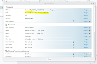

  • change model length units to inch
    • do not use your Custom system of units
    • use PTC system of units named inch lbm Second (Creo Parametric Default)
    • use Convert option
  • apply Regenerate
  • apply Refit
  • show model dimensions
If my test produces correct model, then the problem is related to your Custom system of units.
