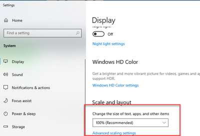

Another selection issue sometimes occurs when your graphics are scale via windows.

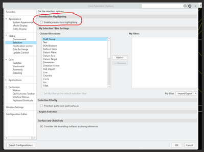

Ok, I may have found something that is causing this issue for so many of us,
I found that if i turn off this "enable preselection highlighting" in the options. (under file/options/selection). I don't have the selection issues when detailing a drawing. Its fast and snappy like previous versions of Creo when adding dimensions,
I don't have to click 3 times to get an edge selected when adding a dimensioning to a drawing.
HOWEVER......It does however suck not having the edge pre highlighted though.
It also REALLY sucks when in the 3d model not having it highlight.
So i don't think this is viable option to always keep the pre highlighting turned off.
But I DO think this is something PTC should be looking at as it maybe the culprit of the selection issues in Creo 11.
Unfortunately preselection highlighting is a key part of how the Creo UI works. It may help as a workaround in some cases, but I would not say that it is the "cause". That said, I do have a mapkey (F1) to toggle preselection highlighting for cases when it helps to disable it momentarily.

Seeing that turning off this highlight function made my selection issues go away.. (though it introduces other issues) gave me hope that maybe PTC can look deeper into this..as there must be something that changed behind the scenes to make this a problem in Creo 11..

One thing that might be somewhat related to a root cause/solution - it seems that part of the problem is that if you hover over an entity when "preselection highlighting" is on, and you have the entity momentarily highlighted in order for Creo to accept selection, it's very easy to very slightly hover past the entity just before clicking. This deactivates preselection and you end up unsuccessfully trying to click an entity that is no longer preselected. It all happens in milliseconds but enough to negate a selection. For example, I try to click a centerline and two successive points in a sketch, and I "miss" the first or second click after the centerline. So to do it again, but I have to be more deliberate and slow down to get it right, which is annoying. It seems like this "click activation zone" was a bit more forgiving in the past - I was working on Wildfire with old hardware just a few years ago and never ever had this problem with fast, successive mouse clicks. Also it was a bit better in Creo 10 as others have pointed out. Perhaps there is something that can be tweaked in the program, such as leaving an entity preselected for an extra few milliseconds or increasing the "click radius". Of course there is also a graphic element to it, as the hardware must be able to achieve quick highlighting to give the user that window to select. If there is any highlight lag, the preselection will fail.
