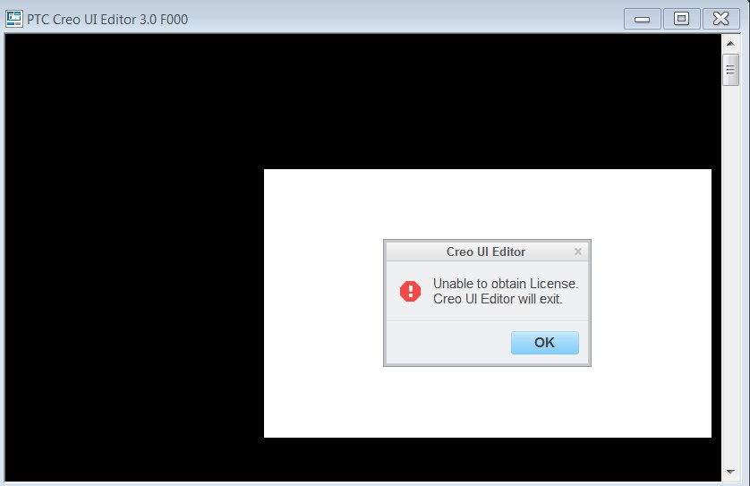

I don't have a trial version. I have an educational one (slightly different) provided by my university. Though it allowed me to install this error appears. Does that mean my licence does not cover those addons?
"Does that mean my licence does not cover those addons?"
It depends on the contents of your license file. Open it in Notepad and look for Toolkit keyword. you can also upload your license file and I'll tell you what is inside.

Hello, it took me a long time since I had left my machine elsewhere. I am back with it now. It was not at ProgramData, but at program files, but, never the less, I've found the licence file. I see the server/port of my licence. What about it? How should I know if it included toolkit?
open license file in Notepad and look for Toolkit keyword. You can upload the file if you want me to check its contents.

in parametric.psf you can find license name, only ... in your case it is PROE_Educ1. To see list of modules available in this license, you can:
-OR-
So... They seem to be included. How can I access them?
during Creo installation, you have to click Customize button and select Toolkit items to install them. Then you have to learn how to use them to create an application. Programming using Toolkit is not easy and I can't help you to learn it.
