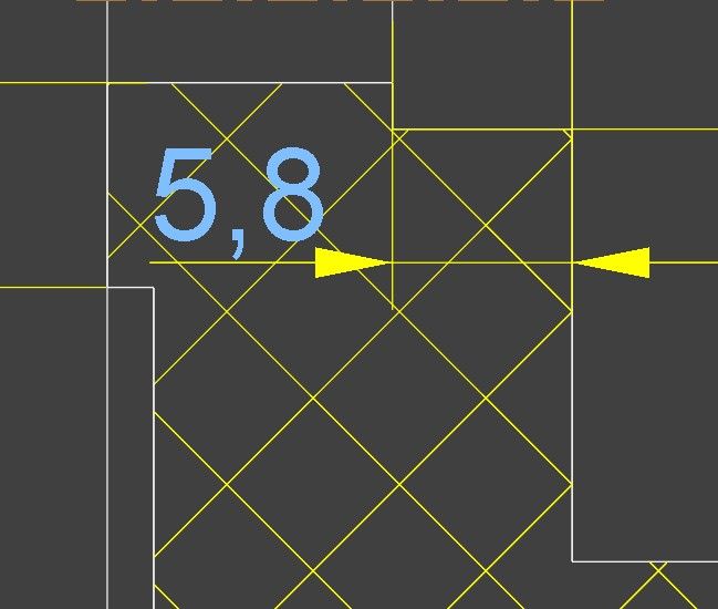

Dimensions background
Hello, I'm having a problem with the dimension background. I want the hatch background to cover the hatch. Unfortunately, this can't be set, and the hatching under the dimension is still visible. I'm working in Creo 10.

there is dtl-option def_xhatch_break_around_text
set the option to yes
to do this
go in a drawing to File > Prepare > Drawing Properties > Detail Options
or edit your dtl-file in 3rd party text editor
the active dtl-file defined by the config file option drawing_setup_file

Addition:
Also def_xhatch_break_margin_size drawing option can be set.

I must have something more messed up because it's not working
create simple test model & drawing and try applying mentioned options. This test will show you whether this is a general error or an error tied to specific data.
