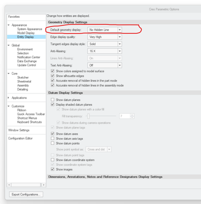

Edges' color change between SHADING WITH EDGES view and NO HIDDEN view
The edges of this part change color between views: they are BLACK in the "Shading With Edges" view and become BLUE in the  "No Hidden" view. The edges are also BLUE in the Hidden Line view (with the hidden line correctly displayed as light grey), and completely blue in the Wireframe view. 
I would like to keep the edges BLACK no matter what, and if that is not possible, at least I would like the edges to be BLACK in the "No Hidden" view and whatever in the other views.
I have played with the color settings for two days now, and I could NOT find the culprit among them.

CREO now starts showing parts in "SHADING with REFLECTIONS", even though the setting is clearly saying Default Geometry Display = "NO HIDDEN LINE".
Any ideas how to fix this, related or not to the first change?
(To:cgherghe-2)
Check the configuration option "display" what is it set to in your Creo session?
cgherghe-2
(To:tbraxton)
This was a bit finicky, but then I added
display hiddeninvis
to my config.pro and all is good now,

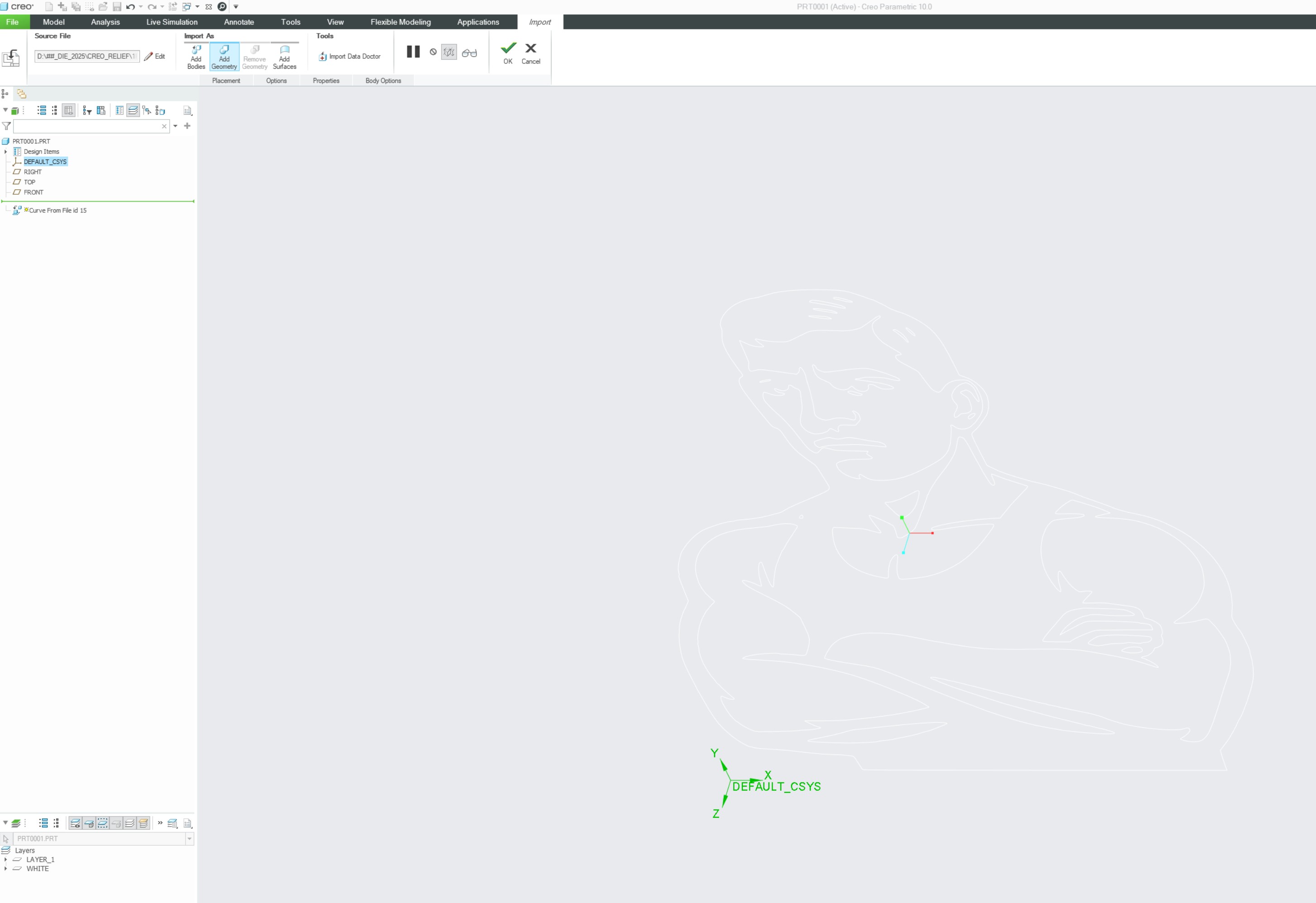

I like the crispness of "Black on White", but when I use the PROJECT button to import a DXF file in CREO, the lines of the DXF are white on white, and that tires me out really fast!
So I adopted the option with the syscol file, where I can make GEOMETRY = BLACK and retain that option, only to have a grey background to go with those white lines.
I wanted to change the white lines to another color, but I could not find the option for those anywhere...
This is what I mean -- no idea how these white curves are called, honestly.
(To:cgherghe-2)
EDIT: There is the possibility to use a mapping file when importing DXF data. This implies that there exists a default mapping of colors, but I am not seeing any documentation at PTC with a quick search. The system colors assignments available to the user in the GUI and via sys color files may not have control the color of imported DXF geometry.

Regardless of that the imported geometry will probably use the geometry color active at the time of import; I am guessing that yours is set to white. Change it as a test to see if that is what is used for imported DXF geometry.

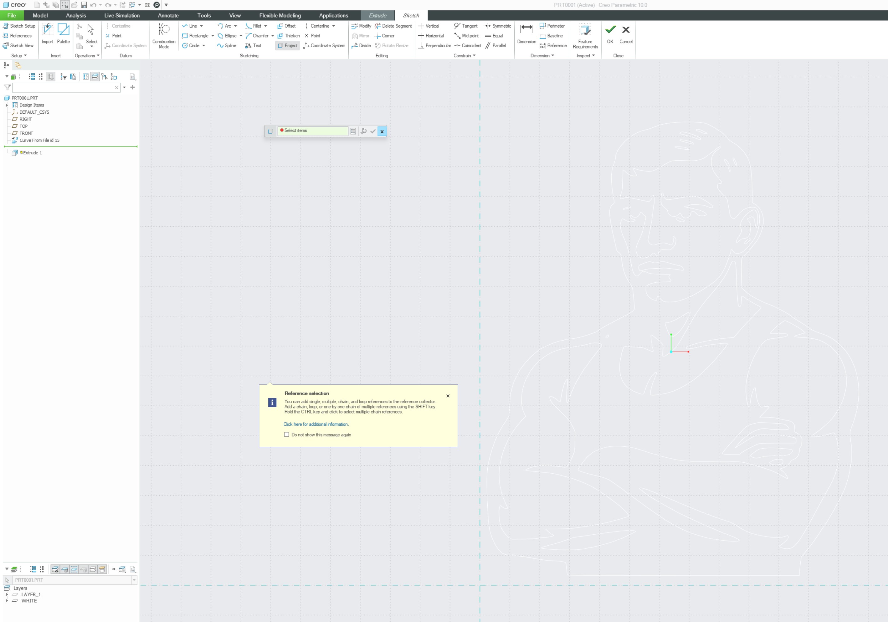

The import of the DXF starts with new creo part, change accuracy to ABSOLUTE, then pick a plane (let us say FRONT), go to the MODEL tab, click Get Data and select IMPORT. Accept default settings in the import window (or perform changes) by clicking OK, then click again OK on the IMPORT tab top ribbon.
Next select again the FRONT plane, click EXTRUDE, then click PROJECT in the sketching area. Two windows should pop-up, kill the bottom large one with info, keep the SMT (Selection Mini Toolbar) top one.
Click with the mouse on any closed curve and you should see a small segment lighting up.
Press the button that looks like a listing or a book in the SMT and the CHAIN window pops up.
Change References to RULE BASED and then select rule COMPLETE LOOP and click the OK button.
You should see the whole closed  loop highlighted in orange.
Click on the SMT button showing the circular green arrow (named "Create Geometry from the collected references and keep the tab open.") and now the orange curve changes to an extrude line.
Move on to the next curve and finish them all like that.
When done, press OK on the EXTRUDE ribbon.
Now change the extrude type to your needs, key in the numerical value of the extrude, and click OK on the extrude ribbon.
You should now have the extrude you wanted from the DXF file -- and this is just my way of using the import of DXF files, to get a flat extrude of a curvy subject (I convert a PNG file to get the DXF one). Other people use these DXF files in a much more sophisticated engineering manner.
