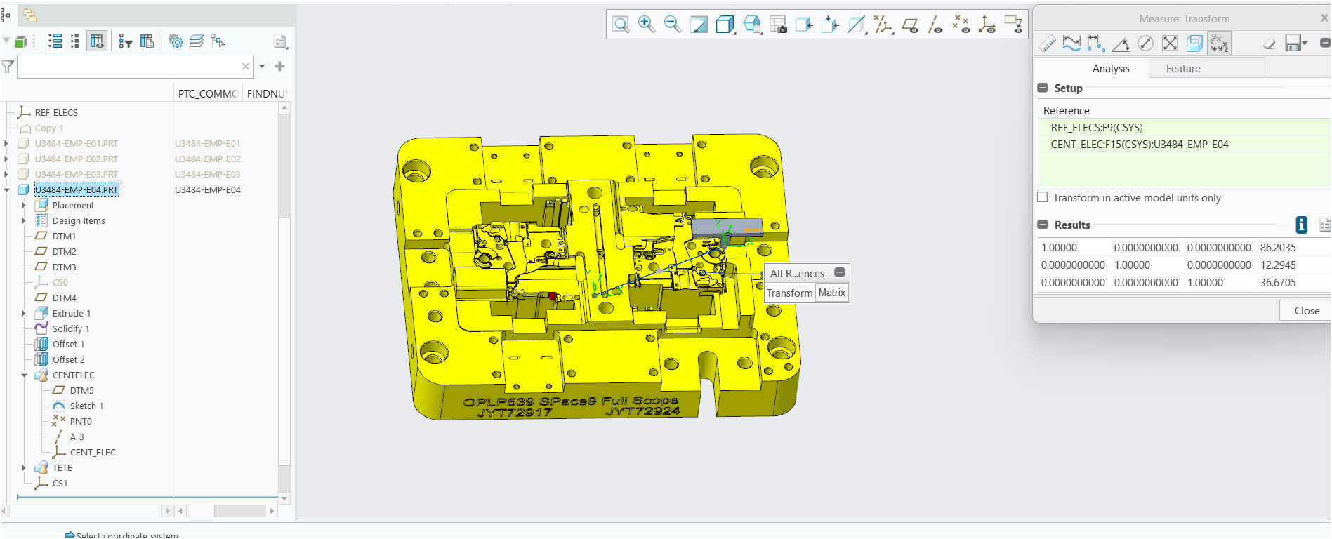

I need to retrieve the X, Y, Z, and C offsets of all components in an assembly relative to the main part’s coordinate system. Ideally, I’d like to export these values into an external file (CSV or TXT).
Is there a built-in method or mapkey/API/Toolkit solution to automate this?

In a CREO 10 assembly, starting from the main part’s reference coordinate system, I need a quick way to extract the X, Y, Z coordinates and the C angle of the reference systems for each component in the assembly. Ideally, I would like to gather all these values into a single file.Thanks

I don’t mean exactly that. What I need is to obtain these coordinates based on well-defined reference systems, similar to the “Measure, Transform” tool, but with the additional possibility of including the “C” rotation (around the Z-axis). I would need all the coordinates — X, Y, Z, and C — compiled into a single supplementary file. The ultimate goal is to retrieve these offsets so they can be transferred to an EDM machine.
