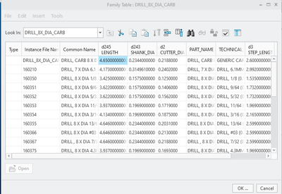

Hi
You can go into the family table & find the dimension you are looking at,
& press add/delete the table columns & click on the same dimension, it will highlight in the window as shown in the picture
Pushkar Khanna
