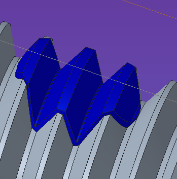

Would anyone know how to model a locking patch screw feature like the one you can find in the STEP files that are available from McMaster Carr with the threads modeled? As the picture shows, there is a very small protrusion coming off the screw threads to represent the locking patch.
I can easily create a datum curve and project it onto the threads, which for all practical purposes is sufficient. But I am quite annoyed that I cannot figure out how to actually make it as a protrusion. If McMaster Carr can figure it out, it seems like I should be able to.
I find the visible locking feature quite handy to make sure the locking patch is actually engaged with the mating threads. Eternal thanks if anyone has any suggestions.

I would suggest using Offset>Expand>Sketched Area.
ptc-2204087
(To:kdirth)
Wow!!! That is awesome!! Exactly what I was looking. I bow down to your Creo knowledge in deep, arcane menu choices 😁
I tried it out, and it worked exactly as you have pictured. I would never have figured that out on my own. Thanks!
