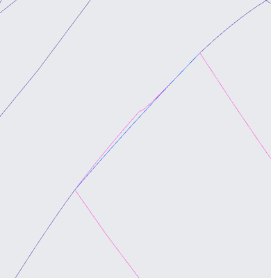

Some of your errors can be fixed in Data Doctor, not with the automated fix routing (which never works for me), but instead using the Edit and Create functions to replace surfaces and edges. Here's a quick example:
Delete this highlighted surface, but the remaining edge has a small curly section that will be problematic for recreating the surface.
So you want to use the UV-Curves to draw a curve between points. That results in the blue curve shown here
Highlight the pink curly curve and use the Replace function and select the blue curve. This will redraw the pink curve using the blue curve. If the pink curve is split into two separate curves, highlight them both and use Merge Curves before replacing it with the blue curve.
