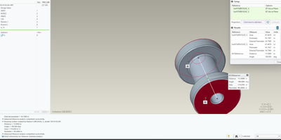

I am using Creo 10.0.7.0 and I was used to taking my measurements without the measure tool on the fly for simple things to enhance productivity and speed. Is there someway I can make this happen in CREO?
An example
I already have a shortcut on the pop up menu but it's easier if I just click an edge or two faces and get an output immediately on the information on the message log.
It already gives me outputs from the measure tool to the message log as shown below.
I want it to
  1. Give priority to 'distance' and show distance in the message log, not perimeter or just show both.
  2. Output length every time I have selected an edge,
  3. Output radius each time I have selected a circle/arc,
  4. Output distance each I have selected two planes that are parallel to each other.
Is it possible to have this in message log or someplace else?

It shows all the outputs in the message log, you either need to show more lines in the message log or you need to scroll in the message log.
To show more or less lines in the message log by default, there is an option in the config.pro
Visible_message_lines 4
where the number represents how many lines you want to see.
