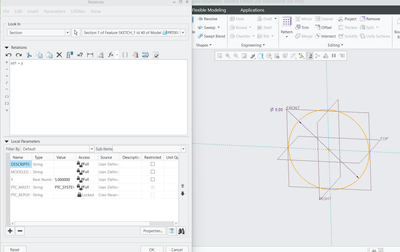

I think I got it, seems like an easy fix. I'll run you down through the whole process.
I create a parameter called x with a value of a 5 in a fresh part.
I make the diameter (sd0) of a circle equal x.
Now I decide I don't the diameter to be equal to x and then click the dimension in sketch feature and delete it It changes colour from black to blue.
I click ok in the sketch and go to my parameters and I find that I can not delete parameter x even though it seems nothing is being referenced by it.
I right click and find it is still being used in the sketch.
Now the issue is that the relationship still exists even though the dimension sd0 does not, to prove this I go into relations and voila it is still showing sd0 = x.
I can just erase that statement and then click verify and now as you can see I am able to delete parameter x.

To recap there is a way to get relations in selected features that is "look in" and then selecting the feature where the parameter is being used.
I figured the best way to avoid this issue is instead of deleting the dimension with the relation it is best to change it.
For example, I have created a new parameter y with a value of 5 again and made sd1 equal it. (Note that the diameter is now sd1 instead of sd0 since sd0 was deleted previously)
Instead of deleting said dimension to change the value I will go into relations and change the value of the dimension there so that it is not equal to y anymore.
I set the value to 22 and verify the relations, the circle now has dia 22 and parameter y is not being used anywhere else and I am free to delete it.
I have made it a bit tedious but I hope it was helpful. Let me know if you have any problems.

I didnt really understand what you meant by "Relations" so in case someone else is looking,
Relations is a whole other button to parameters (2 down on the ribbon)
Thing is you MUST be in the sketch where it was originally done to show up in the relations list. You cant just go there while in model view or it wont show up. This tipped me up for a number of minutes before "editing" the sketch and THEN opening up relations.
But after doing this solution I was indeed able to delete the parameter causing me issues.
I recorded a short video of the "relations" tab in case it might be helpful. Note that I used look in "section" and then selected the sketch later I showed that the parameter y was being used in the same section just for your information. The mp4 attachment will load quicker btw
