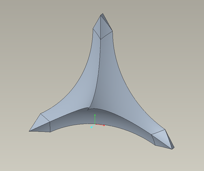

Does anyone know how to construct that star shape with a simple white spine?
I cannot get rid of the central lines generated by the corners of the three spikes, tried blending to a point or to a smaller star point, to no avail.
And when trying to round those corners with an arc, I am having issues with connectivity between the arcs and the segments, and I am not able to get rid of those errors (no idea how to deal with them).
Any suggestion is welcome!!

The lines in the middle are still there, regardless of the closed sketch.
This was about obtaining a smooth surface inside the star when I perform the BLEND, I cannot get rid of the green lines that I drew in the attached picture.

Are you trying to create a surface with a boundary blend from the sketch?  Boundary blend always creates lines between vertices on each side.
If you are creating a planer surface, use Fill.
