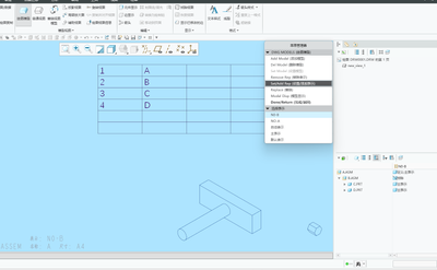

Hello everyone, I created a component in 3D, and then created any simplified representation, such as NO-A, N0-B, and then saved it. Then I created a new engineering drawing and selected a simplified representation such as NO-B, but the repeated area still shows component B. How can I solve this problem? Thank you

谢谢你的视频,但是为什么我的操作还是不能达到你的效果?谢谢
附件是我的模型,能帮忙分析是什么原因造成的吗

In your simplified rep, you have B.ASM set as Exclude which would normally exclude the sub components in the assembly.  However, you have also explicitly included the parts C and D.  The recursive BOM is adding B.ASM to maintain the BOM structure.  If you don't want B to not show try filtering by item to hide B.
kdirth
(To:bduncan)
The repeat region BOM will always show the model/representation of what was active at the time the BOM was made until you change the Model thru the repeat region menu.
Table tab > Repeat Region > Model/Rep > Select repeat region (table) > Select model > Select representation > Confirm > Done

谢谢你的解答,但是我的操作还是不能达到预期的效果
uploaded video show how to remove B item from repeat region.
Note: You do not have to define simplified representation in A.asm
