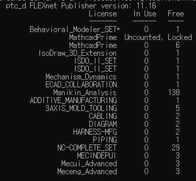

Also this is what showed up when I activated ptcstatus.bat

Since I don't have Advanced Framework in my system information, I guess the problem is installation.
Unfortunately, my company wouldn't let me change anything in installation process, so I'll need to just give up on using the AFX tool.
Still thanks for trying to help me out and I really appreciate it.
in some Creo licenses Advanced_Framework module is included - see picture.
If your license does not contain Advanced_Framework then you will be able to use AFX Lite with limited functionality, only.
Note: I agree that the root of your problem could be "filtered" Creo installation.
