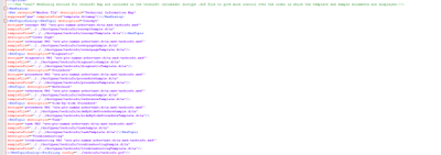

We use a zipped application that has our template files in it  So when users log into our cms the system checks to make sure each user has the latest version downloaded. We can access our templates from the file, new drop down. I did not set it up, but by the looks of things the techinfomap and techinfo dcf files were modified to show the custom files. I hope this also helps.
techinfomap
techinfo
