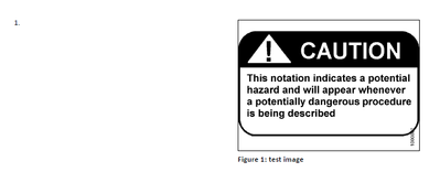

Hi Team,
I tried adding a block border. It results in a border around the block, which is fine if the image is block-sized, however, if the image is scaled down, the border shows up on the entire block instead of the image. I understand that the 'block border' option will always do that. I wonder how we can achieve this without block border.

Sure,
There are two image elements, and one of them has the 'Frame all' Property added.
Essentially it's the same if we add block borders.

I am on DITA. The Frame All option might work on Block elements, It doesn't on Inline elements. Graphic Styles are considered Inline by Default.
Neither Block borders nor Frame-All work.
