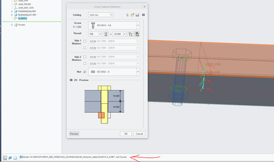

When I start IFX, it creates the folder ‘PATH_ABS_WINDCHILL_DOWNLOAD’ and populates the sub-folders correctly with the catalog files and the .dat files. However, none of the .gif, or .prt are downloaded, and so IFX cannot find the prt seed file in order to create the fastener:
If I manually copy the seed prt files in to the download location, everything works fine. I conclude therefore that for some reason IFX is not downloading the whole contents of ifx_fastener_data from Windchill to the download location, only the dat files.
