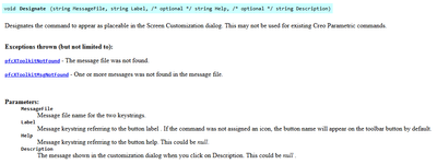

Screenshot from support.ptc.com no directory described:
screenshot from pdf no directory described:
There is also no format and description about how does this file has to look like.
