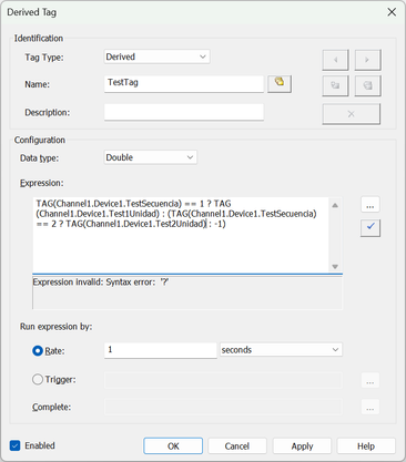

Thank you for your reply. I had tried your suggestion before but it does not like the "ternary operator expression".
Downloaded the latest version just in case this was added in newer versions but nothing (same syntax error as usual).
Tried the following dummy examples:
TAG(Channel1.Device1.TestSecuencia) == 1 ? TAG(Channel1.Device1.Test1Unidad) : TAG(Channel1.Device1.Test2Unidad)
(TAG(Channel1.Device1.TestSecuencia) == 1) ? TAG(Channel1.Device1.Test1Unidad) : TAG(Channel1.Device1.Test2Unidad)
The nested one (the one you described in your post - using grouping parentheses):
TAG(Channel1.Device1.TestSecuencia) == 1 ? TAG(Channel1.Device1.Test1Unidad) : (TAG(Channel1.Device1.TestSecuencia) == 2 ? TAG(Channel1.Device1.Test2Unidad) : -1)
All previous examples throw: "Expression invalid: Syntax error: '?'"
Currently using KEPServerEX 6.17, V6.17.269.0 (customer running older: V6.9.572.0)
