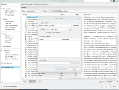

Also, regarding your suggestion on the legacy toolpath: I checked my configuration, but I couldn’t find the enable_classic_nc_steps parameter in my config.pro.

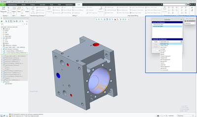

The image below is the profile that I want to machine. I use a ramp angle to connect each slice, this way avoid tool marks at the internal profile.

I’ve already edited my config.pro to enable this option. I hadn’t realized it was a hidden configuration. Thanks for pointing that out!
