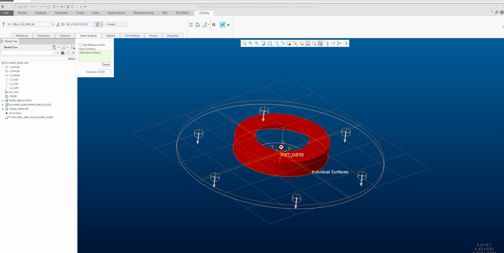

If you specify a check surface with clearance it should avoid running into your part.
I specified the center hub as a check surface with .125 clearanceI specified the center hub as a check surface with .125 clearanceresulting tool path avoids the hub.resulting tool path avoids the hub.

In this case if you select the part as a control surface and set a value just below you can define the start surface below the retract plane. It will avoid gouging into the part.Capture_percage.PNG
