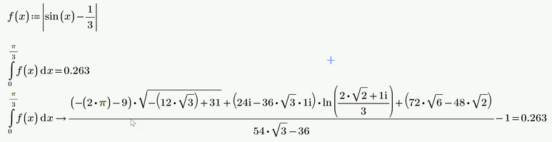

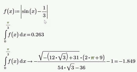

The bug is present in Prime 10 and Prime 9 (can't test with P8 and P7).
Its not present in Prime 6 using the new engine!
Prime 10 & 9:
Prime 6 with new engine (FriCAS/Axiom)

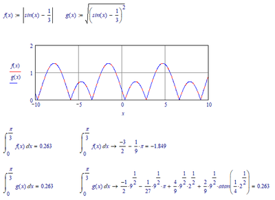

I hate to say it, but the very same example also fails (in a different way) in Mathcad 15 with muPad as engine, too 😞
Prime 6 sheet attached

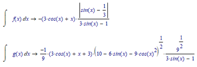

Mathcad 11/Maple
I am sorry to see that Maple in MC11 is coming up with an incorrect result as well when the absolute value is used.
Reason seems to be that, while the symbolic evaluation of the indefinite integral is correct in all versions, all versions (including Prime 6, which so far is the only version which returns a correct result for the definite integral) return a function which is only piecewise continuous.
Therefore this integral function must not be used to calculated the definite integral the 'usual', simple way (which is was all versions except Prime 6 seem to do),
but instead has to consider the jumps at the discontinuities.
To get the correct result we could use

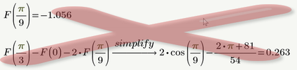

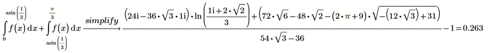

EDIT: SORRY!! The above was awfully wrong! The zero of f(x) is NOT at pi/9 but rather arcsin(1/3) of course!
F(x) is not defined at this position (division by zero, actually a form of 0/0) so we have to use the limes
Somehow Prime 6 is the only version where the symbolic version is able to return a correct result, even though its ugly looking
And of course once we know where the problem seems to be we an also split the integral accordingly o get the correct symbolic result
We get the same results in Prime if we rewrite the function using the square root of the square.
Reason seems to be that an internal simplification ends up at the absolute value again

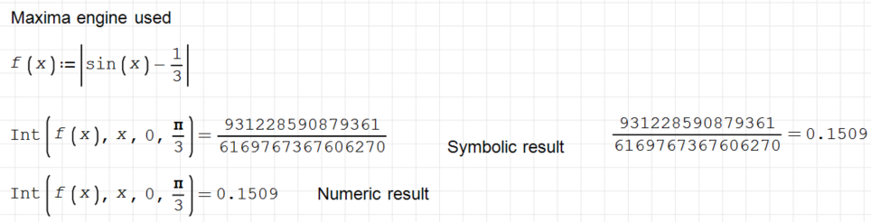

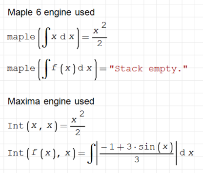

SMath Studio with Maxima engine used outputs these result of this integral:
Thanks for trying.
Its disappointing that SMath returns a wrong result, too.
Both Maple version 6 and Maxima engines are not able to calculate this integral symbollicaly in SMath Studio:
@Werner_E EDIT: in my previous post it was a mistake made by me.

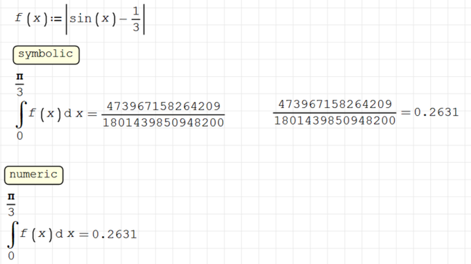

SMath Studio is able to make the correct calculation (SMath engine):
Then I'm relieved. 😉
But shouldn't Int be an integral anyway?
BTW, the "symbolic" solution sure isn't the exact solution (which is what I would expect from 'symbolic') but rather a rational approximation of an irrational result.
I can show to You simbolic solution as well (not a rațional approximation of an irațional result as above), but only tomorrow i can post, as I do not have access to my computer right now.
I tried downloading SMath Studio (or SMath Solver as the app calls itself on my PC). That went OK. The bare metal SMath seems restricted compared to how I recall it operating several years ago, with a greater dependency on plug-ins. I tried to install the Maple Tools plug-in, but SMath crashed twice, so I abandoned the attempt.
Stuart
Yes, so it seems to me that SMath has stability problems. By now SMath can give you the answer/correct answer, and after few moments later it can give you incorect answer or SMath to not work properly. Strange things happen with SMath from what I see so far regarding the stability of functionalities.

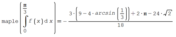

@Cornel wrote:
@Werner_E this is the symbolic result from SMath using maple:
Yes, that's what I really would call a symbolic result. We have seen this very same result already sometimes in slight variations here in this thread.
