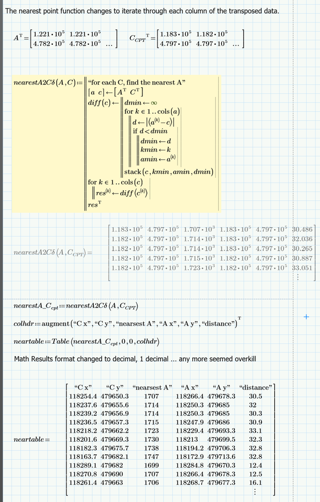

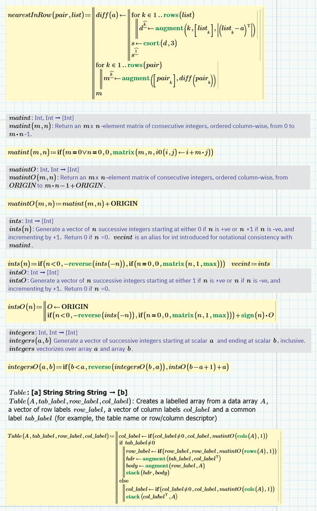

@YA_10963798  Please, pretty please, can you change your variable names "rows" and "cols" to something like "nrows" and "ncols"?  I keep forgetting that you've redefined these functions and spend ages hunting down what I think is an error on my part until I finally (re)notice that rows doesn't mean what I think it does.
I removed the header information from the "nearest pair" array and passed it instead to one of my Table functions, modified for ORIGIN independence.

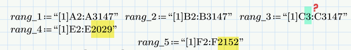

You get different lengths for X.CPT and Y.CPT because you obviously specified wrong ranges!
I'm rarely confident enough to opine that something is "obviously" wrong. However, I did notice your comments but left the ranges alone until Yusra came back with her response to your questions.

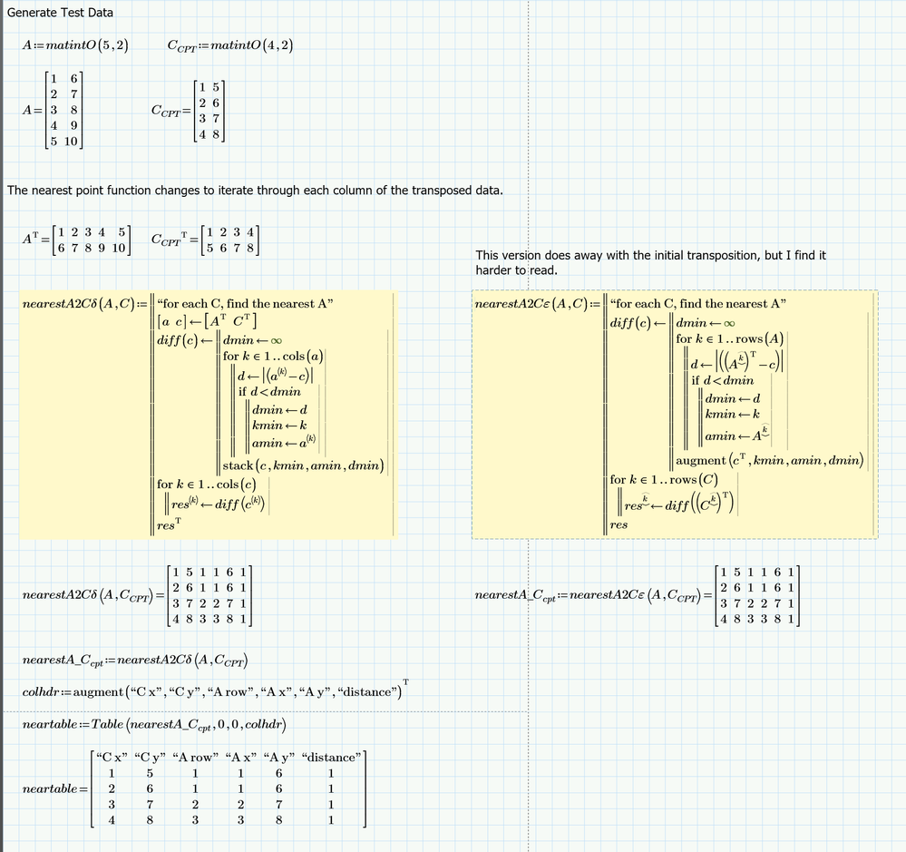

@Werner_E  is right, the change in data format meant the nearest point function no longer worked.
Here's a modified variant of a nearest point function.  It should run slightly quicker than the previous version, but I haven't tested that aspect of its performance yet.
2) Choose the nearest point in A to a point in C
I interpret this as, for each point c in C, finding the point a in A with the minimum distance from c.
This is equivalent to iterating through C and for each c search in A for the nearest a to c.
NOTE: The order of A and C matters as the nearest point in A to a point in C isn't necessarily the same as the nearest point in C to a point in A
Also available with real data:
Also matintO takes integer arguments and doesn't know how to cope with array inputs - if you wanted test matrices of the same sizes as A and CCPT, then pass their respective row counts in matintO's first argument position and 2 in the second.
As an aside, the good thing about using matintO is that the values are small and consistent, and you can manually calculate the expected results for small data sets.
However, sometimes, it is better to test with a randomized range of values that is nearer to the target problem.
Initially, I used a=1 and b=10 as arguments for rndints because it was easier to visualise which points were nearer to which.  I was too lazy to change rndints to mrunif for the larger values ...
Stuart

I corrected the wrong rang_5 string so now X.CPT and Y.CPT are equal in length.
