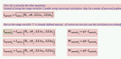

As you mentioned, part of the calculations were removed for clarity, so I assume this was not intended to be the complete solution.
I removed most of the parts in the sheet because they I considered the calcs not necessary for what you demanded - repeating the previous calculation for each block. And I modified my functions or wrote them from anew to be able to do so and then called them in a loop to get the desired outputs.
So actually the sheet was meant to be my final solution to your question so far. 😉
It should be fairly easy for you to find the maximum in each of the three Pw vector and do whatever calculations you need to do, isn't it.
After all the main part was to find the polygons, calculate their area and CG apply the surloads and calculate these values for each angle beta.
So if you need more than whats provided in the attached shee I would suggest that you give the missing calculations a try yourself and if you experience problems ask again and post your sheet.

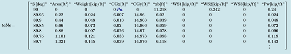

For a single block as in the previous thread the result were nine values (Area, Weight, CGx,CGy, xb, WS1, WS2, WS3, Pw) for each angle beta:
So each block would add another of these nine values.
If there would be, say three blocks as set up in your sheet, what should the desired output be?
  • Three tables like the one shown above?
  • A table with 28 columns?
  • 28 single columns for each quantity as we had it highlighted in red in the previous sheet?

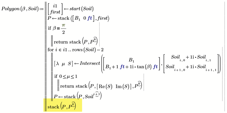

BTW, there was an error in my "calculate" function which only affected angle beta=90°.
The third element in the row vector should simply be deleted:
Also the last line in "Polygon" should be changed. This affected only angles smaller than 34°.
