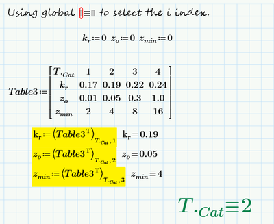

I have a number of questions which pertain primarily to how to use data within list / combo-box etc. to be able to extract a number of standard parameters associated with, snippet's below & file attached
4 is fixed.
5. Using global = to select the i index. This is my favorite method.
Let me start by saying that I have NEVER been a fan of combo boxes. And I'm confused by your sheet. It seems that there are things missing. (You need to have T.Cat defined to have vlookup work.)
That said, What you're showing has drawbacks. For what you've shown, I would build a table. (Tables replaced data arrays from Mathcad 15. If you select data in EXCEL and paste it into Prime, you get a table with blank headers:
One advantage of tables is that they allow units. (Combo boxes will too, but that can get tricky, look for previous posts!) In tables, you type variable names and units, and you get arrays.
And a lookup is just as easy:

@ttokoro Just to clarify, would you expect the 5th option to look like below, just want to make sure I am not missing a trick, thanks.
With Combo box to select the T.cat values from 1 to 4 only.
Note that when using (Prime) Tables, you are totally free to add any (combination of) units to any of the column variables. With a Combo box, only simple units are supported (You can e.g. have m, but not m/s); the Combo box is a badly integrated (probably third party) element, just like the Chart component.
For clarity I'd propose:
You can extend the table in horizontal and vertical direction (see the right side of attached sheet), the TableValue and ParameterSet functions require no further change, unless you want to add error trapping.
In addition: you should be very careful when using global definitions (using = ). Consider what happens if you globally define the same variable in different locations of the worksheet...
