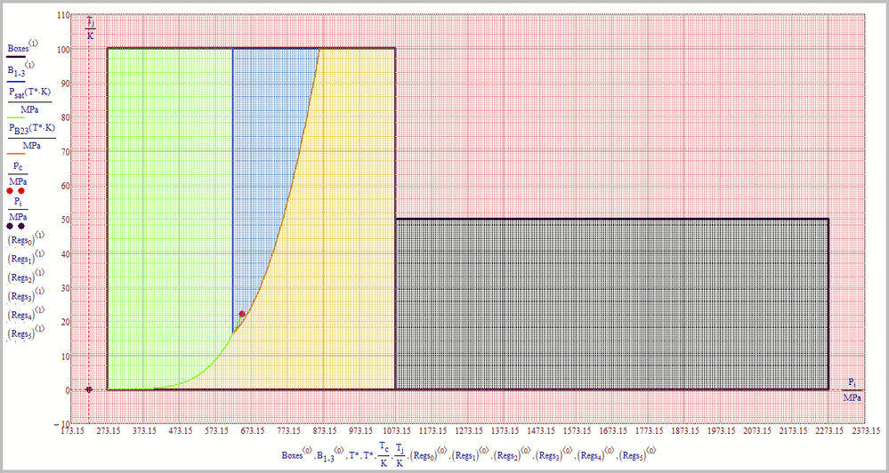

In this case, I need to determine in which region of IAPWS-IF97 (formulation for thermodynamic properties of water) the point lies on a pressure-temperature plot.
P-T Diagram, Validity range of IF-97P-T Diagram, Validity range of IF-97
So, here is the question itself: wich model of (p,T) function would be faster and easier to calculate (e.g. on a low-spec hardware), the one with separated IF`s, or the one where IF`s combined with usage of multiple "and (˄)" and "or (˅)"?

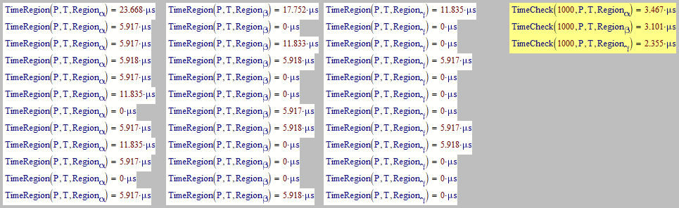

perform timing tests (use the time(0) function) by calling each function multiple times using a series of predefined values of T, p
Thank you for pointing out onto this time() function, didnt know about the existence of such.
I used it to test out my functions, file attached.

Here are the results of your timing tests on my (slow) machine.
I also added a test using slightly less than 1 Million evenly distributed in the whole area visible in your plot. Time shown is the total calc time, not divided by the number of points checked.
I would say that even though the third approach is slightly faster (in this run, pressing Ctrl-F9 you might see another 'winner') they all are equally well.
I converted the sheet to Prime 11.0.0.0 and recalculated it. Of course multithreading was turned off as otherwise timing would not work.

Just for fun I added the points differently colored to your plot (its no surprise that none of them is in 'region' 4). So there is a visual check for plausibility of the region test function(s).

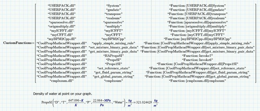

Looked into it a bit deeper and you need to specify IF97 like this

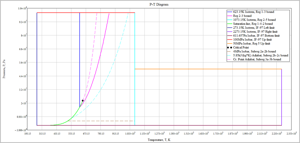

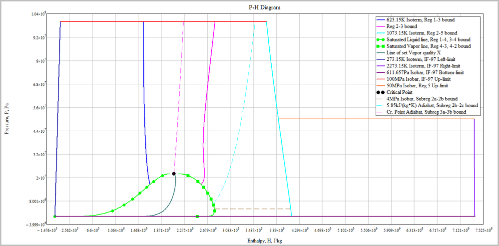

And to be fair, I was planning to post it here (as separate topic) after I finish polishing everithing. You already can see how it performs on this diagrams (pictures from november 2025, but here are only boundaries)
IF-97 P-T Diagram Mathcad.pngIF-97 P-H Diagram Mathcad.pngIF-97 P-S Diagram Mathcad.png

Great graphs in your last post
