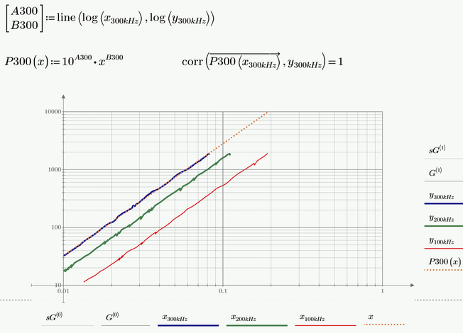

If the goal is to find a separate fit for every frequency given, you could also use "line" to do so.
Here for 300kHz:
"B300" is the very same which you called "b". But you would get a slightly different value when you do the same for the other frequencies.
10^A300 is your a*f^c with f=300.
But I guess that you are looking for constant values a, b and c which are valid for any frequency.
To find these values I would suggest using a solve block with "minerr":

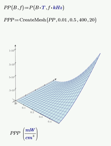

Thereafter you may define a function P which is only dependent on B and f and because with Prime we are using something similar to Mathcad, it may be a good idea to add correct units
Now you can use this function with any input value you like
and of course also for plotting with different frequencies
And as its a function with two arguments, you may also create a 3D-Plot if you like
Prime 10 sheet atached

For example below are the data points for the 3 lines: 300kHz, 200kHz, and 100kHz lines from above graph.
MCP10 file attached.
Both x and y axis are log scale.
Now we need to find the values of a, b and c coefficients in such a way to be able to generate these lines also with the above formula by fitting these curve with that given formula, by using genfit/mineer or something similar mathcad functions.
Have done the first line for you.
Here for 300kHz:
