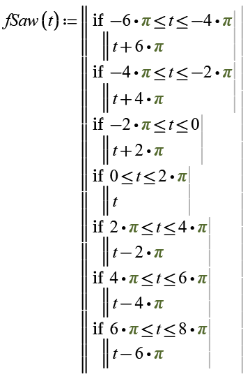

On the graphing stage, I do not have any idea on how I would graph it, but here is my file on my fourier series exam.

Mathcad Prime:
(To:Cornel)
Nice,
but, how would you proceed if you had to extend it from -100, 100...
There's a handy mathematical function, also available in Prime, that allows you to convert a running variable (like t is) to a short sequence..
It is somewhat related to division. I'll spoil your assignment no further.
Anyway, here is the result:

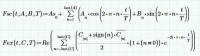

(To:Cornel)
You can use an even simpler function (no programming required, works also in Prime Express) to calculate the Fourier coefficients of a periodic function:
As an example, take a square wave as a function of t, with period T, offset O and amplitude A:
e.g.:
Define:
Calculate the Fourier coefficients:
(Note that Re and Im are Premium functions, they do not work in Express,
but they can be easily built with:
Now you can build the Fourier representation with either one of:
The first uses the A and B vectors and the sine and cosine functions. The second uses the array C with complex values.
The results are:
I've offset the Fes(t) function by 0.2 to be able to see it alongside Fs(t)
You can cut it short in a single function now, defined as:
Example for a triangle:
Last example:
Now it's up to your imagination regarding periodic functions.

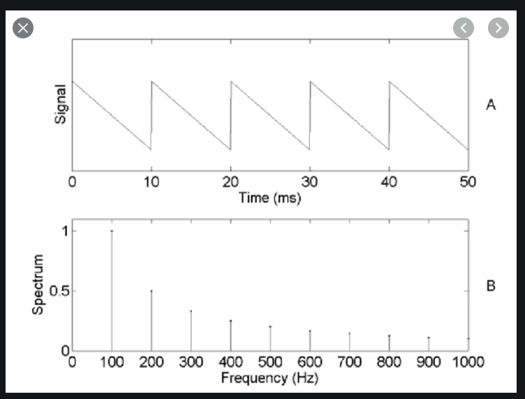

Cornel
(To:LucMeekes)
@LucMeekes@ttokoro@Fred_Kohlhepp@-MFra-@Teddy
How can achieve the Fourier spectrum for these kinds of signals that were derived in this topic?
For example:
These images are an example to show you the idea.
I think you know what it is all about ... the Fourier spectrum of a signal.
The spectrum does not necessarily have to be performed for the signals in the image, but for those that have been deduced in this topic, but it is also possible for these of course.
But as much as possible to use @ttokoro functions.
(To:Cornel)
To create a spectrum from data, use the dft() function. It is built into Prime.
Be sure to consult the online help and view the examples provided by Prime.
