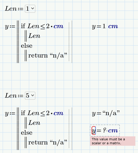

I am getting error for programming could someone please help

Problem is the unit cm which you add at the end.
If "Len" is larger than 2 cm your program returns the string "n/a" and you can't add a unit to a string. You can add a unit to a scalar numeric value or to a matrix of numeric values, but not to a string - hence the error message.
BTW, inline evaluation may work OK most of the time but sometimes can lead to unexpected effects. Therefore, I have made it a habit to always separate the definition of a variable and its evaluation/display for safety reasons, as shown in the image above. This also shows clearly that it is not the program that causes the error, but the attempt to display a string with a unit.
