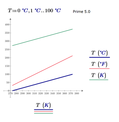

Help please - see the attach
Oviously it does not work the way it should (by simply chosing °C in the unit box) so one crude way is to do the conversion manually. Not very satisfying, I guess.

Think we found a bug in Prime 5!
What you show was exactly what I tried first (and Valery sure did so, too) and it failed because we both used Prime 5.
It works OK in Prime 4 but throws an error in Prime 5!
So the bug was freshly introduced with Prime 5 (and we thought there would be no development of Prime any more 😉

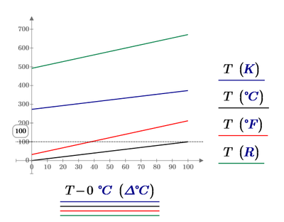

I understand what is the problem. X-axes allows K or R and not degree C or degree F. (x=x*unit ,not x=x*unit+C*unit)
So x axes can use the unit of delta degree C.
But Prime 4 (Expresseven) allows deg C on the x axis as well
