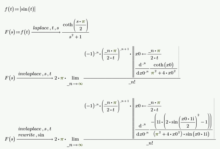

Currently using MathCAD v15 (M050). I have Prime 10 but am having licensing issues at the moment.
Anyway, I'm having trouble understanding why the invlaplace function won't evaluate as shown in the attachment. If I remove the absolute value sign, then it all works as expected (am I just running up against a domain issue and need to use the "assume" keyword.....or something......?)

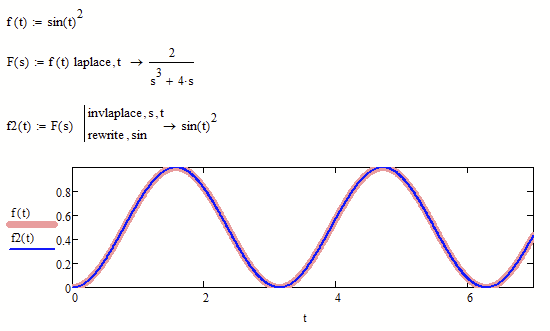

In Mathematics the absolute function is kind of a beast which usually is quite hard to handle.
Much more difficult like a simple function like the squaring
or even the Heaviside function
(we see "1" instead of "Phi(t)" because the result of course is valid only for t>=0).
We could try to rewrite the absolute value using the modulo function, but unfortunately the laplace operator can't deal with the modulo function
Looks like what you demand is too hard for the symbolics in Mathcad.
Its also too hard for Prime's symbolics:

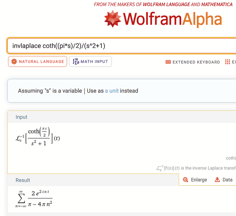

And Wolfram Alpha isn't able to come up with the desired result |sin(t)| either:
