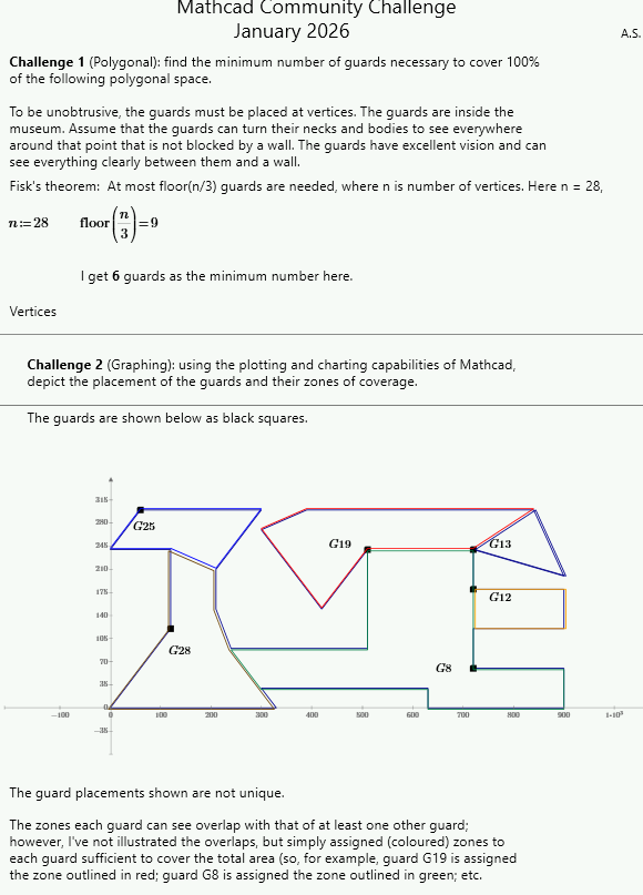

There seems to be an error in the vertices table. Although a number of dimensions are missing in the Creo screenshot, fortunately the relevant one is specified:
Here's my simple starter for the polygonal version only.
Alan

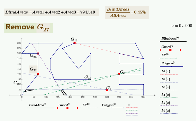

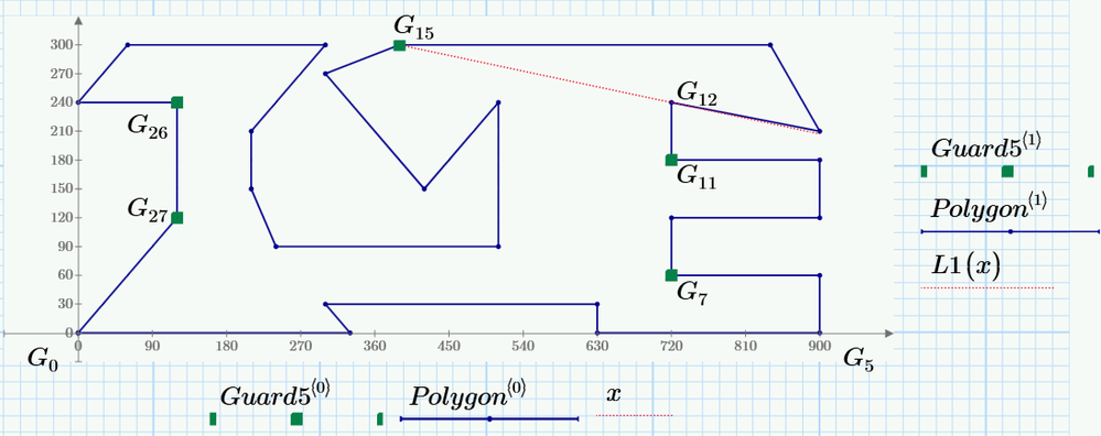

Using AlanStevens method, I make 5 guard positions answer.

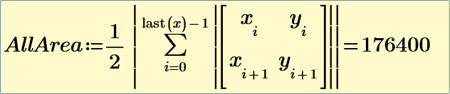

The total area is 176400.

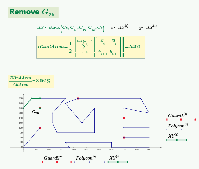

Change some positions and remove guard G26, the uncovered area is 3.06%.
But when remove guard G27, the uncovered area is only 0.45% by 4 guards.
Removinf G2, the blind area is 3.55% for 5 guards.
