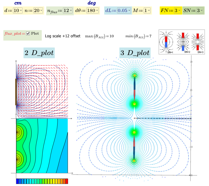

Version 2. Trying to plot line current and its magnetic field lines in 3D.

Version 3. Trying to plot Terry and Werner's dipole magnetic field lines in 3D.
FN=1 to 3 changes the start points of flux displayed.

Version 3b2. Trying to plot Terry and Werner's dipole magnetic field lines in 3D for 3 types of SN=1, 2 and 3.
nflux can change the density of magnetic flux.
dL can change the resolution of calculation.
M can change the magnitude of Magnetic dipole moment.
N can change the size of n*n calculation field.
flux_plot can on/off to plot flux lines.   etc..
3D plot of each element must <40000, so if exceed it red boundary line appears.

This means more challenge requests to the users! So, the Ver. 4 is 3D plot of toroidal coil magnetic fluxes.
How to plot the coil and curved arrow in 3D are the challenges. And also change the color and size of plots that changed by advanced input controls are good tips.
How to change the direction setting which is under the plot, without using global definition, is also good tips.
