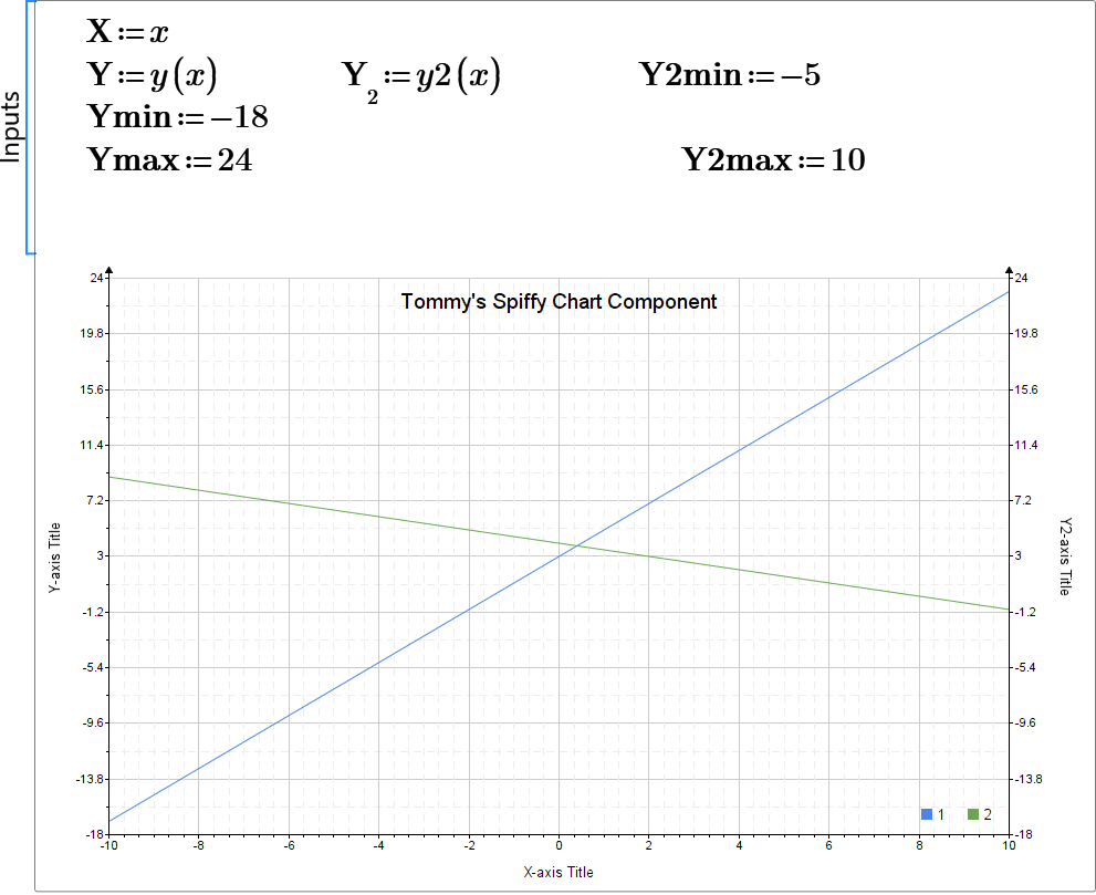

So what's the deal with 7.0, all?  The boss took it for a spin yesterday and said it's a non-starter, he'll keep us on 15 as long as possible.  And this is a YOUNG guy.  He actually LIKES Micro$oft "Word", a strange program purporting to be a word processor, but really designed to measure user aggravation level prompted by software randomly "helping" you.  I think it's tied to somebody's psychology PhD thesis or something...
Anyway, the young boss noted that the plots don't even support a second "Y" axis.  Did he miss something?  We also link in a library of user-added functions, and last I heard that ran a lot slower with Prime as well, maybe that's his other beef.
Maybe. Primes 2D plots (we won't talk about those incredible lousy 3D plots here) are missing a lot of other things like labels, grid lines, legend, more formatting features, compared to real Mathcad (and real Mathcad never famous for being able to produce quality plots for publication). So in the newer versions of Prime, PTC has added a third party chart component. Its badly integrated, extremely slow, does not support units, does not scale according to the screen resolution (and so is quite unusable with a smaller 4K display), ...
But, alas, this chart component supports a secondary y-axis, grids and labels 😉

Oh my goodness.  I don't even have time to be doing this, but like a moth to a flame...
What in all that is good and true is that chart component? Seriously?  What am I missing here?  I've been half an hour trying to figure out how to get a trace to plot on the second Y axis. I have the second trace on the chart, but can't find any way to bind it to the second axis. You can't name your traces for the legend.  As near as I can tell, you can't move your legend or your plot title off the chart grid.  As Werner noted, don't even dream about 3D.
I set axis limits for the second Y axis in that flyout window you get when you double-click on the chart.  They did not change.  I set the Y2min and Y2max values in the Inputs area above the Chart - nothing changed.  If they were aiming for "intuitive", they missed.  So I thought, "Maybe I have to set Y1min, max first...?"  Oh no, Y1min isn't a valid variable name. Okay, it's Ymin & Ymax.  That set the limits on both the Y and Y2 axis and also changed the tick interval so there's no zero labeled...  Did they take lessons from the folks who torment us with Microsoft "Word"?
Ok, I'm new at Prime.  I get it.  But I've punched chads representing octal code out of cards for a Monroe-Lytton programmable calculator in 1972.  I've programmed FORTRAN, MATLAB gui's, AutoLISP, I've attached my own subroutines to ANSYS FEA solvers, done FEA in Mathcad (which I've used for the last 30 years), used all sorts of software for charting and plotting... I should be able to figure this out, right?
Sheesh. I gotta go back to paying, time-constrained work.  Just not with Prime 7.0 for now... Lessee, in 4 years they should be up to 11.0m I wonder what that will look like?

Ok, finally found the Y2 axis binding... and yes, you can name the traces for the legend...  But it's slowww.  and the cursor acts whackadoo in the flyout box dialogs, you can't see what you're typing.
Flyout dialog apparently overrides Y2min and Y2 Max
