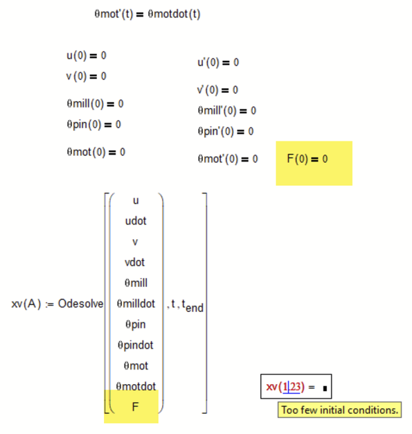

The problem with the second solve block is that an undefined function F(t) is introduced.
11 equations but just 10 initial conditions is what triggers the error message.

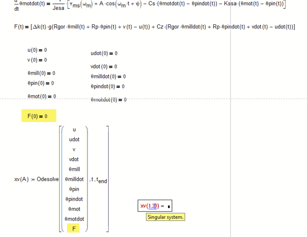

If we add function name "F" to the functions to solve for (even if there is no ODE for F) for and add a (dummy ?) we get a "Singular system" error.
I can't say why or how to fix it, though.
In your third try at the end you already suspected that F may need an IC as well.
You again have 11 equations but just 10 ICs and functions to solve for.
But if I add this IC and also add "F" in the list of functions to solve, this time Mathcad still moans about too few ICs
Again unfortunately I have no idea how to fix this 😞
