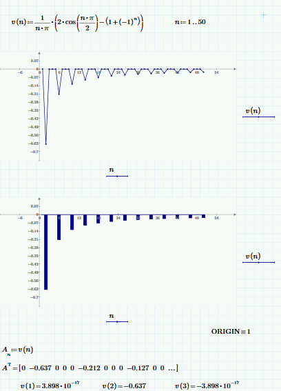

I have a quetion.
I attatched the file.
I do not understand the error on last plot of file.
I think "n" is no problem.
Best Rgs
ssato
Everyone, I understood well.......
I agree and as I don't see any rational reason for this error I would call it a strange Prime bug.
Prime seems not to like the fact, that only every fourth value is non-zero? Not sure what exactly causes that bug.
But I can confirm that it should work and it also does work OK in Mathcad 15
I found two possible workarounds to do it in Prime (not satisfactory but at least you get your plots):
1) change the factor 2 of the cosine to something close to 2
2) change the step width of your range n to 1,1.5 .. 50

Fred, your function v differs from the original function. The 2 is only a factor of the cosine.
Sorry, needed more coffee!
Still:
Yeah! Lack of coffee really can have bad side effects 😉
But nonetheless we see that your Prime 3.0 plot is quite happy with that expression.
So the bug seems to be newly introduced in Prime 4.0 (guess it works still OK in P31, too).
Maybe the only left-over of the plot enhancements we were promised that Prime 4 will include.
Here is another workaround using a different, but equivalent function:
Here are two other workarounds using the round function
I also noticed, that if we change the range from n:=1,2...50 to n:=1,2...7 Prime has no problem. But as soon as we go up to 8 or more - error. Thats crazy.

Don't we just need n to be a vector (not a range)(add the = sign) and vectorize the equation?
Fred_Kohlhepp
23-Emerald I
(To:DJF)
There are two primary uses for range variables:
  1. As indices for vectors, and
  2. As plotting independent variables.
If making n a vector fixes this problem in Prime 4, then it's still a bug, and an aggravating one.
(To:DJF)
Sure, this is a valid workaround, too. Given that we don't need n as range later.
Point for me is that it should work as initially done and due to a, obviously freshly (as Fred showed) introduced, bug it doesn't.
I might add a third use to Freds list - ranges are also needed in programs for for-loops.

Thank you. everyone.
I will attach another file.
If "a" is an odd number in the last graph, an error will occur only with graph creation.
If "a" is an even number, no error occurs.
In the end, is this a bug in Prim 4.0?
If you are a bug, where should I contact?
(To:ssato)
It sure IS a bug and obviously a new one as Fred head shown that in Prime 3.0 it works OK
