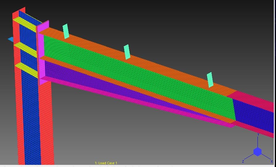

This is what the finished finite element model looks like generated from a few parameters using Prime.
My aim is to save steel tonnage in portal frame buildings.

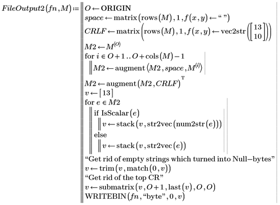

I, too, can't think of anything else than creating the large vector and using WRITEBIN.
I won't claim that my function in the attached file would be any faster than yours, but you sure have the large data at hand to testdrive it.
It looks to me that your version adds a blank line at the top of the output file. If thats OK for you you can change in my function the ["dummy line"] for [13,  10] and delete the submatrix command at the end.
Of course you may also change my CR LF (13, 10) for CR (13) only if that suits your needs better.

Here is a version where only one "if" is left.
But I fear that the operations done on a huge matrix M to create the new(!) matrix M2 may more than compensate for the saved if-statements. Guess that the additional memory consumption should not be a problem for Prime (it could have been a problem in real Mathcad).
Give it a try if you feel like doing so.
If its no problem that empty strings result in Null bytes you may remove the "trim" line
if its no problem that the file start with a CR(13) you can delete the "submatrix" line
EDIT: A first timing test is not promising but its just using your 3x3 data matrix and so may not be a good indicator for how the functions would scale for larger matrices...
EDIT2:
I guess its not necessary that you test the new function with your large data matrix. I stacked and augmented your demo matrix to create just a 30x30 data matrix and here are the results:
It looks that so far your AssemblePRN is by far the fastest solution 😉
