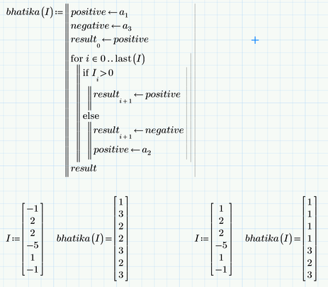

BTW, is this something near to what you are looking for?

Thank you very much. I think this is the one I needed
I love my Crystal ball 😉
To make it clear, the logic behind my function is:
.) First element in result vector always is a1
.) Now we go through the whole vector I. If the element there is positive, we add an element a1 to our result, otherwise a3
.) The above is true until we come to the first negative Element in I. From then on, the game changes a little bit as positive elements in I result in a2 (and not a1) to be added - negative element still yield a3.
You may get rid of the variable "negative" in my function and use a3 instead. And of course you don't have it to be a function if you don't like that but turn it into a simple variable as you had it originally.
