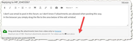

I don't use email to post in this forum, so I don't know if attachments are allowed when posting this way and how you would deal with 'em..
In the browser you simply drag the file to the area below of the edit window or click there to browse for the file.
