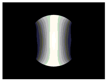

I don't think that there is another way as the one you described.
But I would suggest turning the whole procedure into a utility function.
Here is one suggestion. I called it "Rotate" with a capital "R" and implemented it that way that the angle is given in radiant to be consistent with all other functions using an angle.
Remark: Unfortunately Mathcads old Animation modul does not support a big color-depth 😞
The slight jerking that can be observed is due to the fact that the centering of the image has to be realized with integer pixel values.
