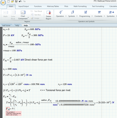

How can I define the variable that I already found using solve symbolics, without copy pasting the result?
I tried using the solve block, but I couldn't get the results for some reason. so I converted the two equations to one, then I used solve symbolics and found one of the variables. However, when I tried to I try to write the variable which I already found, underneath, it says the variable is undefined?
The variables I need to find are Ft1 and Ft2
