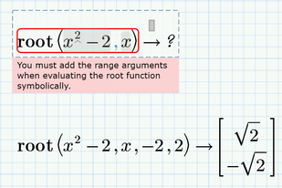

In Mathcad 11 root is not per se a numeric function:
I haven't found examples of Prime (trying) to use root symbolically...
(To:LucMeekes)
Mathcad 15 and also Prime will not accept the 2-argument flavor of "root" but insist on using the 4-argument form. There is no logic in doing so as the symbolic evaluation of "root" does NOT require the function values of the end points of the interval to be of opposite sign and will happily return all roots within that interval.

That explains why I did not find examples in the help files using the root function symbolically. The preferred method is to use the solve keyword.
What happens if you set the two range parameters wrongly, like 0, 2  (does it find one root...) or -1, 1 (no roots) ?
(To:LucMeekes)
In case of interval [0;2] both MC15 and P5 return correctly just the one solution in this interval.
In case of [-1;1] only P5 fails with no solution found. MC15 strangely switches into float mode and returns both solutions. Only when start and end value are the same, MC15 fails, too.
