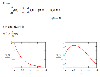

I'm having problems with mathcad. I got a assignment in which the attached script was given.
For some reason it doesn't work though.
Any ideas?
(To:Jonirt)
1) you can't write the differential operator d/dt  by hand - you have to use the menu/palette or the keyboard short
2) Your system seems to be setup wrong - there is no solution

Well, I don't have Mathcad 15, when I open this in Smath it looks pretty lame.
Done in Prime 4 Express (so we can't write a solve block to do an odesolve,) see if this helps.

Fred showed you your error in setting up the equation and also a nice way to do it without "odesolve".
Here is the correct way to do it in the manner you tried and to other possibilities - all using odesolve (which unfortunately means "no units" in Mathcad 15):
